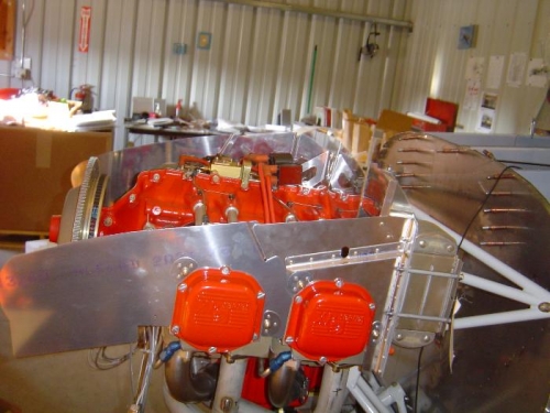

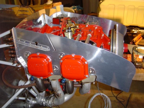

Brief Description:  baffling construction
Mostly completed construction of rear and side baffling. Due to lack of high temperature RTV, the scat tubing flange was not riveted and neither was the nearby joint between the right and rear baffling, in order to facilitate riveting the flange later.
