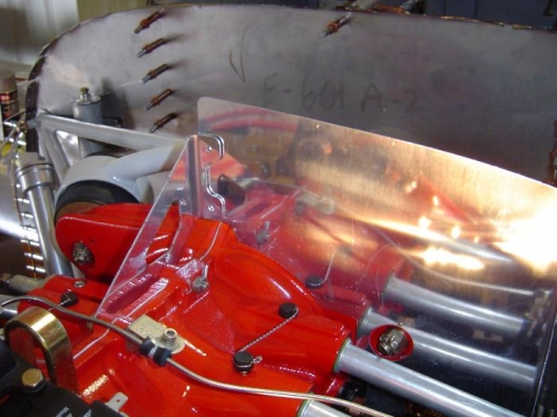

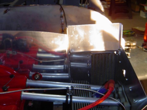

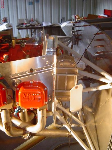

Brief Description:  split canopy and baffling construction
Made the 'big cut' on the canopy and lifted the tip-up portion away from the roll bar. Added more Sikaflex to the roll bar to form a canopy seal. Finished riveting the left rear baffling and trial fitted it in place with the oil cooler installed. Decided to remove the lightspeed coils from the engine case and relocate them so I could use the Van's baffling support.
