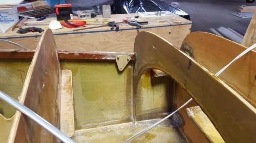

Removed the C-22 moving mount for C-20 - between the electric aileron trim (auto pilot) and rudders functioning as a backup control system, I decided the split trim mechanism on the canard wasn't necessary. Saving a little weight and reducing complexity! I don't get to do that much...

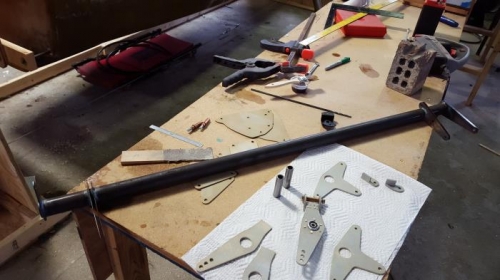

Also finished up the C-27 today. Just gotta make the mounting brackets now and get some paint on everything.

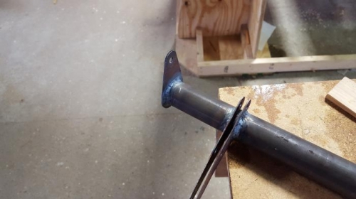

Fixed mount made for the left side of C-20
Completed C-27
Completed C-27
