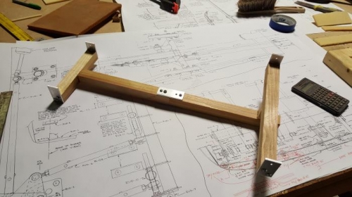

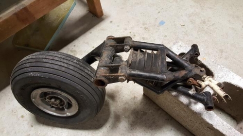

Mostlye spent the night making the jig from the service bulletins. Received the nose gear I ordered from $315. I'll have to rebuild it, but it's not all that bad. Good deal I think. The picture of the jig isn't shown quite right - as drawn, the fixture doesn't actually fit that purpose, but if you flip it from the image shown, and make sure the dimension is 18.44, it works out and fits just fine! Had to learn the hard way, but it works out.
Laying up the plies in the nose gear box next session...
