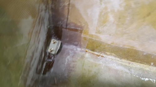

- Install FWD seat belt anchors

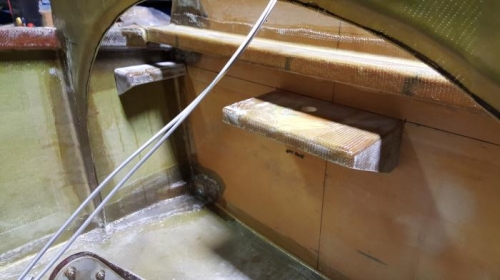

- Attach rudder pedal mounting locations to airframe (drill hole first! - 1" at 2.15y x -0.4x).

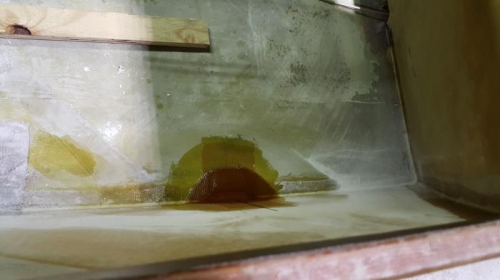

- Layup hardpoints for SB retractors.
- Laminate DWA-3's and WWA-1's
Hanging rudder pedal shelves installed
Seat belt retractor anchor
