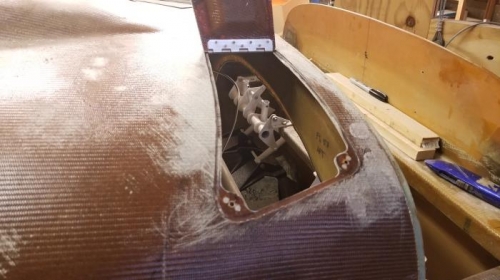

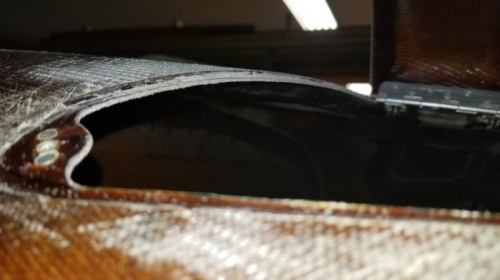

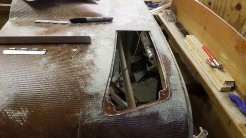

Cleaned up the flange and installed nutplates. Installed the hinges on the panels and then attached them to the turtledeck. Hinge is attached to panel with rivets and to the turtledeck with 2 screws/nut plates.
