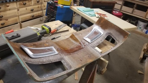

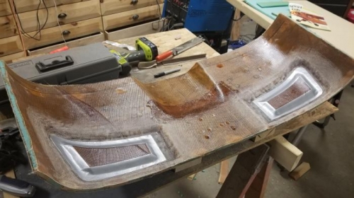

Starting the access panels
First you cut them out... Then you put them back after a release layer of duct tape. There are mixing sticks hot glued to the hidden side to keep the panel in place for the glassing operation.
