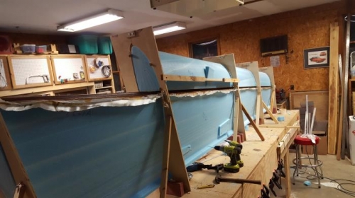

Reattach leading edge

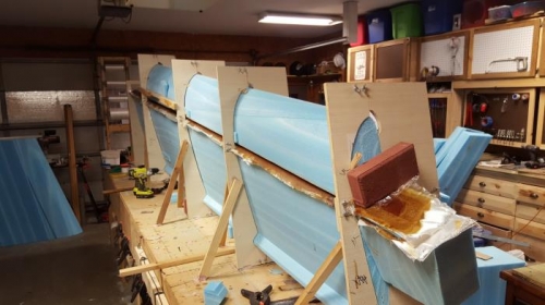

Reattached the leading edge on the right wing. Used some blue foam as a faux spar cap in order to have a flat surface to glass the spar stub fabric that was left over from the leading edge shear web.
Wetting out the stub glass
