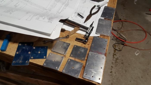

Brief Description:  Patterns and WA's

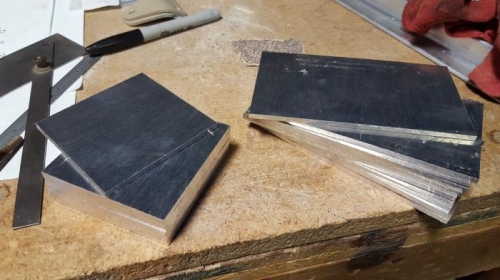

Made the A and B patterns, and got started making WA-4, 4A, 4B, 3 and 3A. I actually used my table saw to cut the 1/8 aluminum. This shouldn't be tried with lower grades of aluminum, but it cuts 2024 fantastic. Fine tooth, carbide tipped only. Watch out, it bites!
I'll finish these up next session.
Off the table saw
Off the table saw

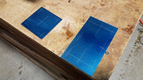

A and B patterns marked
1/4 holes all stack drilled.
