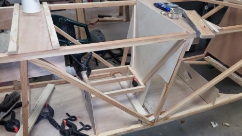

Brief Description:  Created and installed forward seat back
The previous builder put the aft ash block in the wrong spot, so some quick work with a vibrating tool cut it out and I placed it forward where it's supposed to be. The aft end of this block should line up with the front face of the forward seat back. I did go ahead and cut an angle on the ash block to have a flush fit with the seat back.
After that, I cut the forward seat back and the 1/2 x 1 supports, and epoxied everything in place.
After the clamps were removed.
