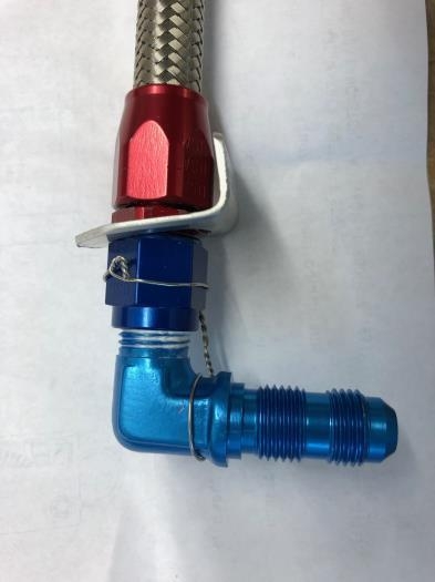

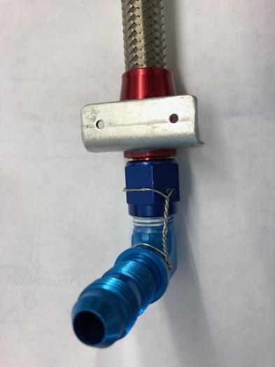

assembled flop tubes and safety wired the AN fittings. Temporary installation, then drilling of the anti-rotation plate went more easily than envisaged.

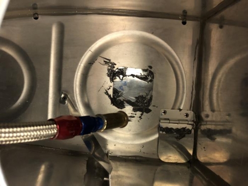

fitted the fuel sender and prosealed them....truly horrible job at first... then realised that I'd fixed the left sender in the right tank, hence the difficulty lining everything up.
MEK cleans the proseal off very easily so potential disaster averted!
After a gloss of wine, I started again and it went well. The proseal sicks like shit to a blanket onto clean surfaces.. fingers, gloves, screwdrivers, floor and table top... a bit of liquid soap on the gloves makes it easy to smooth off though, and without affecting the structural bond beneath.
safety wired tank fitting and anti-rotation plate
ditto
ditto
