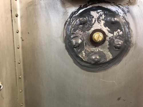

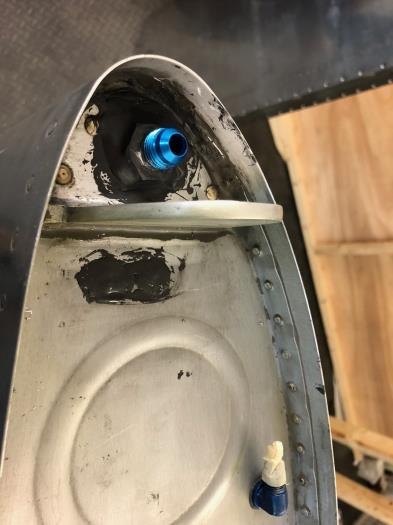

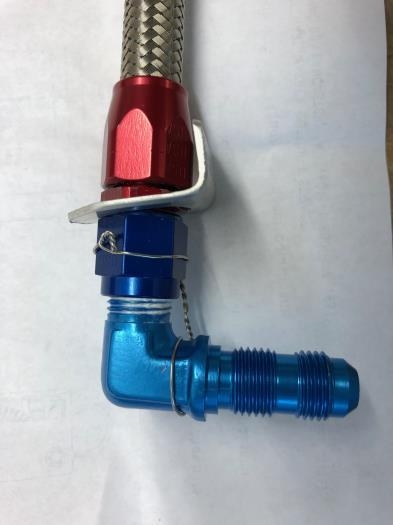

Safety wired flop tubes prepped and anti-rotation plate fitted. Trial assembly was good.
Proseal time again!
All went smoothly, and I think that the bulkhead fittings are well sealed. Rivetted the antirottion plate to the first rib and all sealed up. I'll tidy it up the 'overspill' with some MEK later.
flop tube bulkhead fitting sealed and attached.
