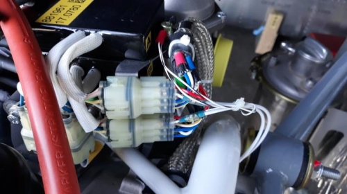

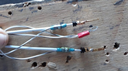

I received my 18 awg sheilded single conductor wire, stripped the ends, soldered sheild wires, installed sealing boots and crimped & soldered the connector pins and sheild termination. I then installed the wires into the A and B ignition connectors, routed and labed the wires.

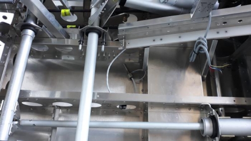

I'm looking for a place for the temperature probe that is out of the sun and away from engine exhaust. I'm thinking through the floor behind the passenger seat, but I'll look at other installations before I commit.
magneto and shield assembled
wires installed to ignition circuits
looking for a temp probe home
