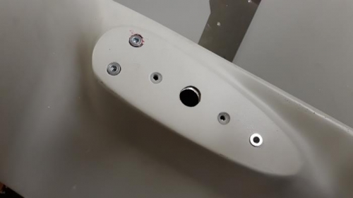

Brief Description:  Added rivets to wing tip light mounting plates
I saw that another builder had added additional rivets to the wing tip light mounting plates, and decided it was a good idea since I had so much trouble getting the rivnuts installed properly. I added two, countered sunk 1/8" rivets to each plate.
drilled & CS for 1/8
drilled & CS for 1/8" rivets
riveted plates

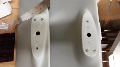

riveted plates

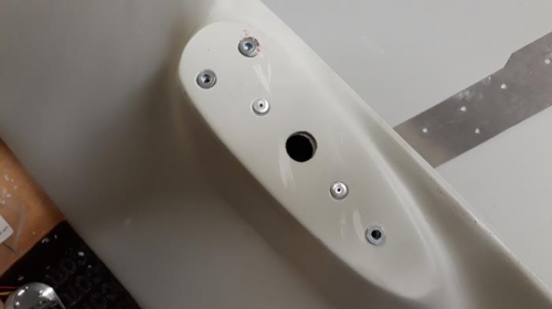

both plates riveted
both plates riveted
