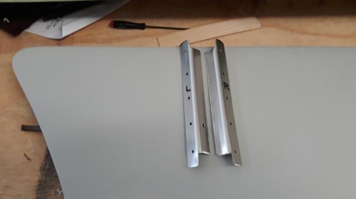

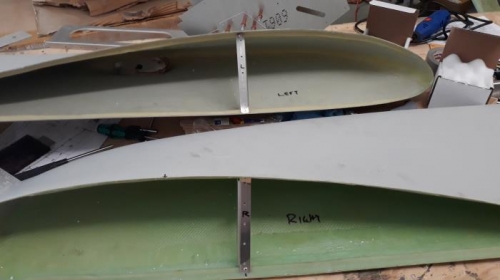

Brief Description:  3 - fabricated and installed wing tip expansion br
I used a 1.5mm thick aluminum angle to fabricate the two braces, match drilled rivet holes through the internal spine, and riveted them in place. The tips fit nicely now.

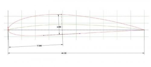

After the install, I pulled up the airfoil and put in a SolidWorks sketch to check my work. It looks really close to the correct thickness, and once riveted in place it should look and perform well.
NACA 4415 airfoil brace location

braces installed
braces installed
