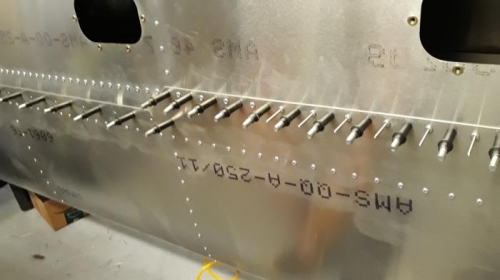

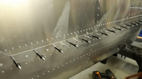

I clecoed the right wing tank to the wing and then bolted the brackets to the spar. I used loctite 277 on the bolts and torqued them to approximately 25 in-lb. I then clecod the 1/8" rivet holes on the leading edge skin and riveted them together. Next I installed 5/32" rivets on the far, trailing edge step of the fuel tank skin. Finally I drilled out the trailing edge fuel tank skin hole that attach to the main spar to 3/16" and installed rivets.

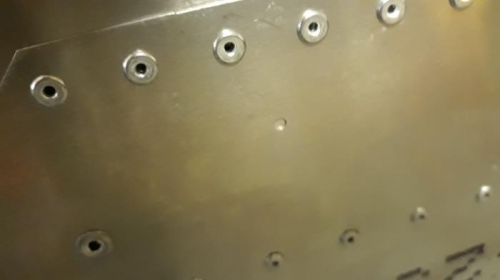

There is one hole on the bottom of the skin with no matching hole on the wing, so I drilled a 1/8" hole through the skins and installed a rivet.
Installing 5/32
Installing 5/32" rivets
Installing 3/16
Installing 3/16" rivets
mystery hole
mystery hole
