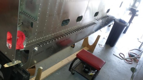

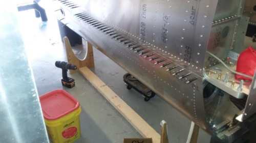

Brief Description:  2 - closed right fuel tank with sealant
I prepped the right fuel tank with methylene chloride, applied sealant to the skin and back channel, then riveted the mounting brackets to the channel. I then clecod and bolted the assembly to the right wing, matched drilled the tank skin rivet holes to the wing and then clecod and riveted the back channel to the tank skin.
Both fuel tanks are now hanging from the wings while the sealant cures. Friday I'll take them off and start preparing for leak checks.
bottom side of right fuel tank
top side of right fuel tank
