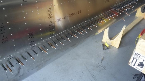

Closing up left fuel tank

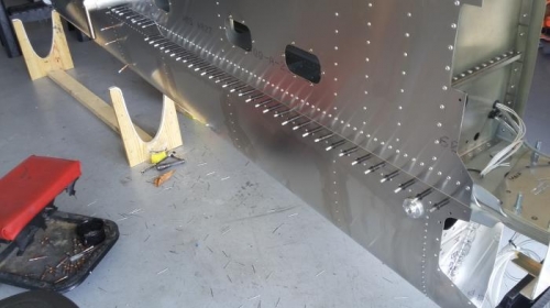

left fuel tank ready channel ready for rivets

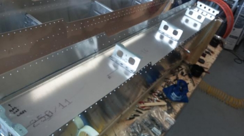

left fuel tank riveted and cleaned
