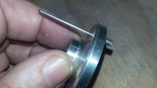

The manual calls for 3/2 x 12mm sealed rivets for the fuel drain flange, but non are included in the kit, and they even have an instruction page that says none are included in the kit but you should use them. I don't have any, but I do happen to have 3.2 x 8mm CS sealed rivets, so I countersunk the flange for these.

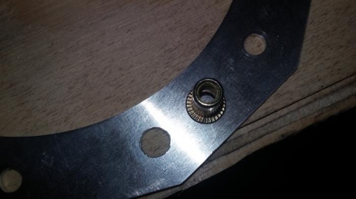

I also had to enlarge the holes for the M4 rivnuts on the fuel sender nut flange.

CS sealed rivet fitment
enlarging flange holes for rivnut plate
