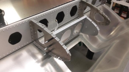

Brief Description:  1 - Added rib rivets & riveted landing light assy

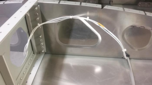

I had one spar bracket with incorrect holes that I upsized a few days ago, but some of the holes were oblong, so I added 3 more rivets to the bracket. I also drilled a hole for the landing light wire and tie-wrapped it in place.

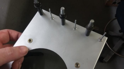

I completed riveting the landing light assembly, installed it to the wing, and then clecod the bottom of the leading edge skin in place. I also attached the top tip skin with clecos.
added 3 rivets to spar - tie wrapped wire
riveting light assembly
riveting light assembly to wing
