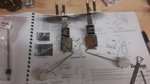

Assembled re-configured fuel level senders

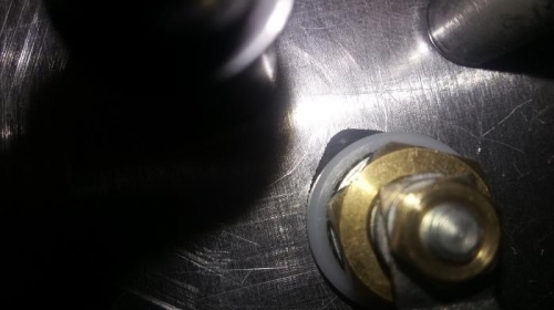

I assembled the re-configured fuel level senders per the drawings. I damged the o-rings in the process, so I ordered pack of 8mm ID x 2mm wide Viton o-rings.
re-configured sendor shown above

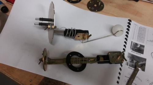

left & right fuel level senders
o-ring popped out side and split
