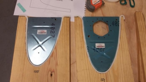

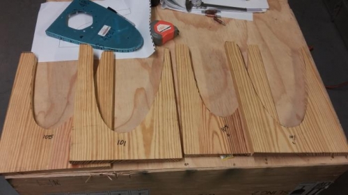

Brief Description:  Cut templates for fuel tank fixtures
The templates provided in the manual were not to scale, so they just kind of show you what to do. I used ribs 101 and 105 for template guides, and then marked with a sharpie about 1/4" away from the ribs. I was carfull to try and maintain horizontal and vertical edge distances consitant with the drawing.
I used a 1"x12"x6' board for the templates and cut the shapes out with a jig saw.
fuel tank templates cut

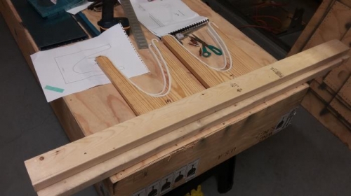

Added foam rubber and test fit ribs
cut base mount connectors to length
