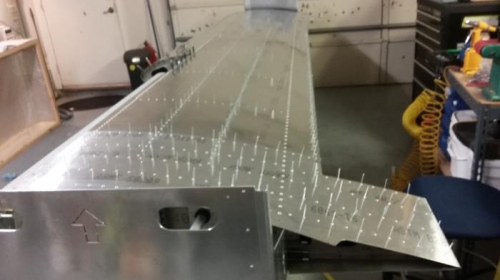

I closed the leading edge skin and cleco'd in place, adjust cleco's as neccessary to keep a reasonable level bubble on both ends for the twist. My twist will be a little under since I couldn't keep the bubble exactly the same on both ends, but it's within the marks. I'll need to look up or measure what degree change I have done.

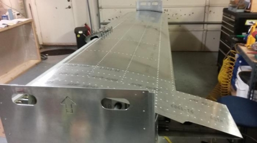

I riveted all of the top skins in place, and there is minimal skin distortation. I'm pretty happy with the results.
aligned and cleco'd
aligned and cleco'd

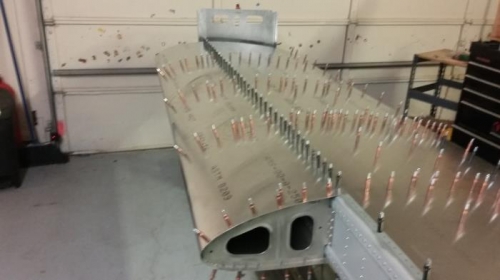

half rivets in, half to go
top side riveted
top side riveted
