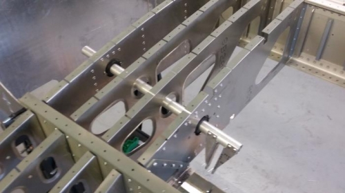

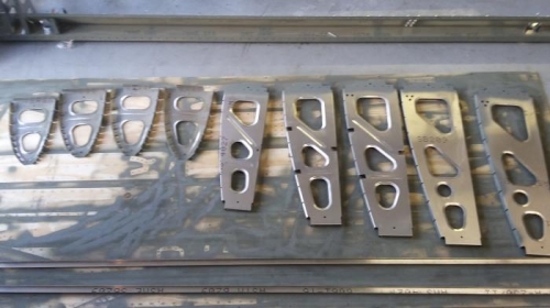

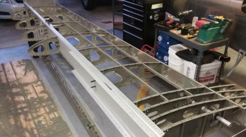

I primed the mating surfaces of the remaining ribs and then installed them to the wing assembly with clecos. I riveted the root ribs in place one at a time as there is no room to install them all at once and then rivet. I also install the in-wing flap torque tube and the skin stringers. I'll rivet everything tomorrow. Too hot in Texas today.
primed mating surfaces
installed flap torque tube
re-assembled wing
re-assembled wing
