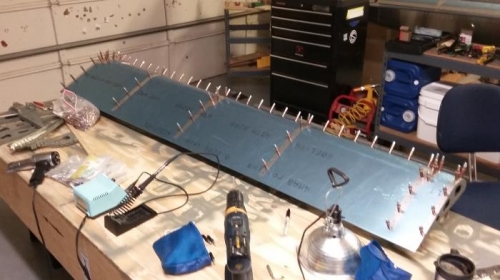

I used a soldering iron to remove the film from around the rivet hole areas of the flap skin, and then primed the inside mating surfaces with self etching primer.
I clecod all of the right flap ribs in place inside of the skin and riveted the assembly together
right flap rib ready for rivets

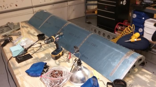

right flap completed
