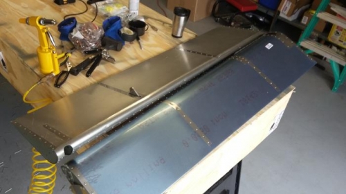

Completed Ailerons

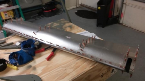

I clecod the ribs and leading edge tube to the aileron skins, clecod and riveted the assemblies. Rib #3 (second from left in pic 1) was tight on both assemblies and required some massaging to prevent wrinkling or puckering of the skin overlap.
Ailerons ready for rivets
L&R Ailerons riveted
