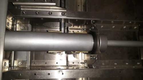

I did a little rework on the pilot side control stick as the friction was quite large. I discovered that the rear bushing bracket wasn't parallel with the front one, so a little persuasion with pliers bent it a tad backwards and relieved the stress.

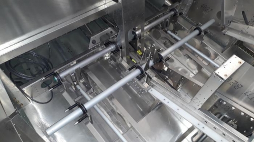

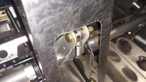

I installed the eyebolt for the long elevator pusrod and then installed the flap torque tube.
adusted bracket angle
installed elevator eyebolt
installed flap torque tube
