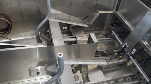

Brief Description:  3 - Installed elevator crank & pushrods

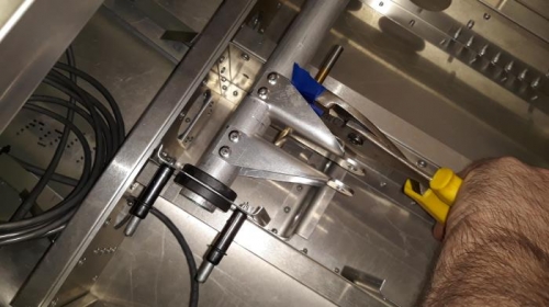

I started assembling the crank while clecod in position like the drawing, then realized that this will be a much easier task if I take it out, asseemble then install. Sounds obvious, but when I'm trying to follow the drawing and instructions, it sometimes removes common sense.
I pre-assembled the crank on my work bench, installed the rod ends to the stick, installed the crank, and then installed the pushrods like a turnbuckle.
Not easy to work on it in the plane
Pre-assembly on the bench
