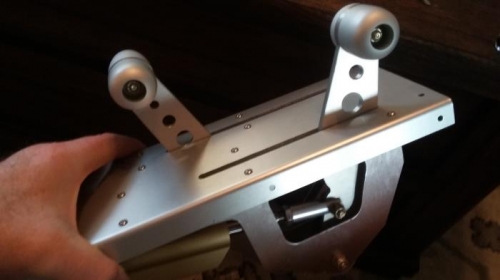

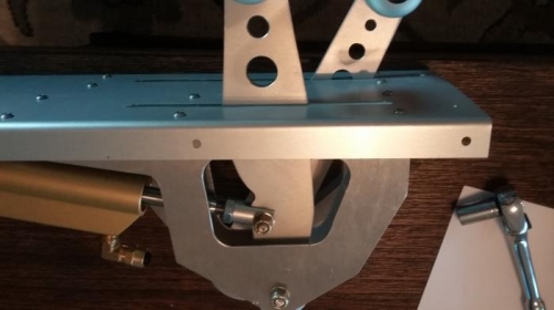

Installed longer clevis on master cylinder
The hand brake didn't allow a full stroke of the master cylinder because of the short clevis supplied in the kit. I ordered the longer version from Matco, and it works perfect now.
short clevis (supplied)
long clevis upgrade
