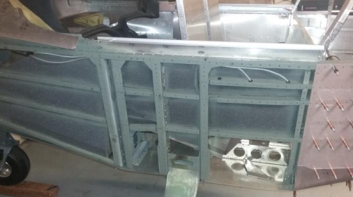

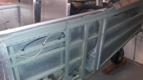

Brief Description:  Routed wire & coax from rear to central fuselage

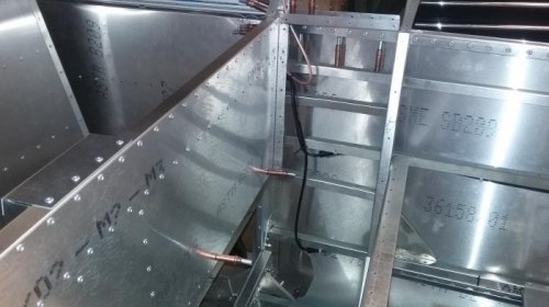

I removed the central fuselage side skins (again) so I could gain access for wire & coax routing. I routed the elevator trim and strobe wires, but I don't have wire yet for the map lights that will be routed on this side. I couldn't use the PE tubing that I used before because it would be to large for the route, so I have also ordered some 3/4" split cable sleeving that I will use on both sides. I routed the coax cables on the right side as well and tie-wrapped them at the transition from aft to fore.
left side wire routing
right side coax routing
coax transition to forward fuselage
