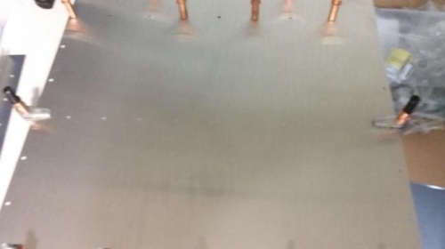

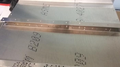

I started the assembly of the second seat back and noticed the channel 009 was not channel 009 at all. The rivet holes were of incorrect pitch and it was a tad bit short. Not wanting to wait for a replacement part I made due with what I had, clamped it in place and matched drilled the rivet holes with the skins on both side. I matched drilled the hinge as before on the first seat back and then clecod the assembly together.
match drilling channel 009

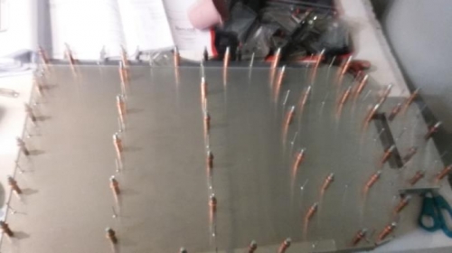

channel 009 clecod
channel 009 clecod
ready for rivets
ready for rivets
