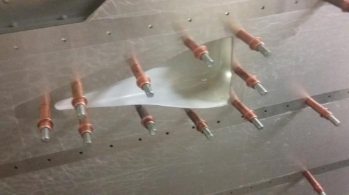

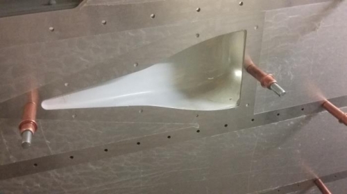

Brief Description:  2 - Drilled and clecod the air duct rivet holes
I placed the fiberglass air duct in position to the opening in the outer skin, and drilled the rivet holes one at a time as I placed clecos in the hole before drilling the next one. I then labeled them Left and Right as they will need to be removed before permanently installing with sealant and rivets.
First two holes drilled and clecod
remaining holes drilled and clecod

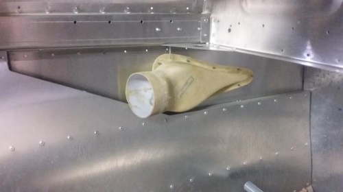

inside view of fitted air duct
