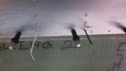

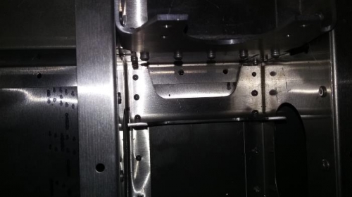

I used two wraps through the vacant holes from the top so that I could easily identify which rivets to drill out from the bottom. I drilled out the rivets, installed the lower control brackets, and then riveted them in place.

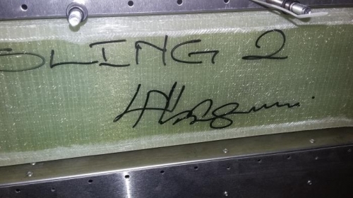

While underneath I noticed the main gear composite was signed by someone; presumable the guy who layed it up.
tie-wraps through holes show location underneath
lower control brackets installed
Someone is proud of their Main Gear
