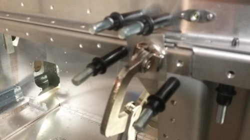

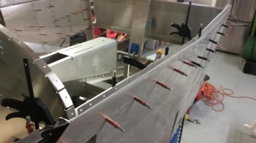

I clecod the inner skin to the outer skin and used this fit as a gauge to position the skin mounting rail in the correct position. I then drilled new holes for rivets next to the old ones.
outer skin clecod to bracket under top rail
skin removed with clamps in place

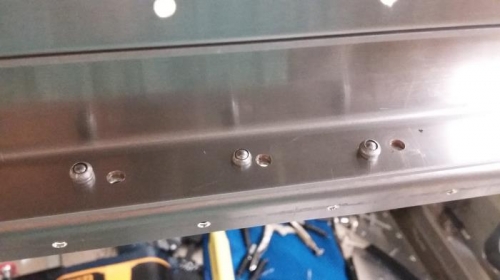

drilled new rivet holes in top rail
