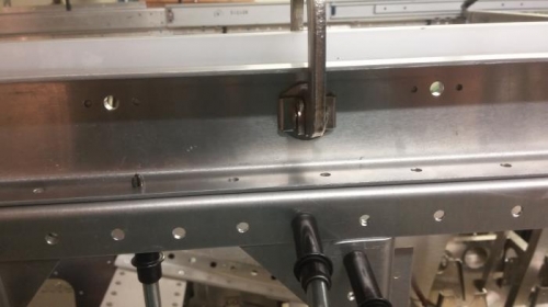

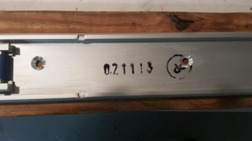

Slide modification for canopy
I clecod the canopy slides to the top rails and matched drill the extra 2 holes required for the 5mm screws. After I removed them from the rails, I countersinked the hole for M5 Flat heads.
slides clecod and clamped in place
new M5 clearance holes drilled
M5 countersinks
