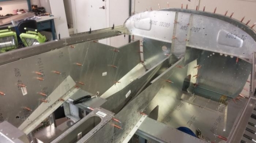

Brief Description:  1 - Prefit various cockpit skins & brackets
I decided to not be surprised as much when I get to parts that don't fit, need mods or holes drilled, so without taking the coating of the aluminum, I prefit several parts onto the cockpit to get a feel of things to come. Most of it fit well, but there are some issues.

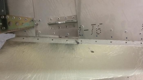

The forward inside skin will need to be trimmed and several rivets in the floor will need to be removed for them to fit properly. The forward console upright has perfect holes on one side, but the other has 4 or 5 larger holes in random positions...not sure about that yet.
I may be missing some firewall bracket hardware (AN5-7, -5) but I'll keep looking.
L & R labels on parts are pretty much useless at this point, as they are wrong at least half of the time, so I just look at the drawings and figure it out.
Prefit of various parts
Need to drill out rivets and mod skin
