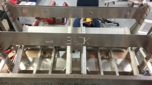

I had to drill out a few (3 per side) previous rivets in the console ribs for the seat rails to attach, then installed and riveted the seat rails in place.

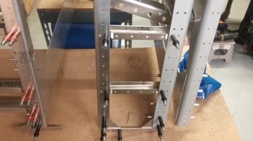

Clecod gussets and upright supports. The gusset ties (-005) are shown on the drawing but not listed on the parts list. The holes don't line up when the supports (-006) are installed. In addition I have 2 extra gussets; maybe they are used somewhere else.
installed seat rails
Gussets, supports & ties
holes don't match upright spacing
