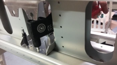

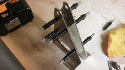

Brief Description:  Main Spar flap acutator bracket
Assemble the flap actuator bracket and installed on the main spar. The mounting holes on the bracket and the spar had been drilled out for 4.8mm rivets although, so I had to drill out the main spar bracket as well. Very tough to rivet within the confines given. It would have been better to do this before the previous step.
Flap bracket assembly

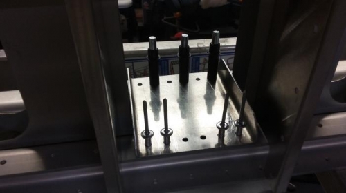

main spar bracket 3/16
main spar bracket 3/16" rivets
Tough to rivet
