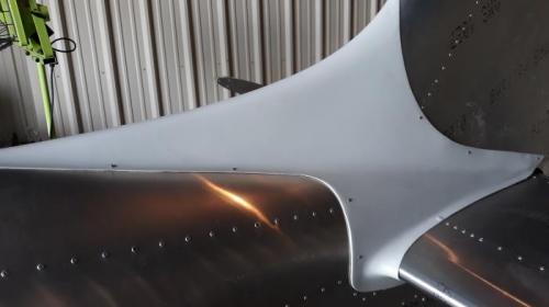

Brief Description:  5 - fairing install complete

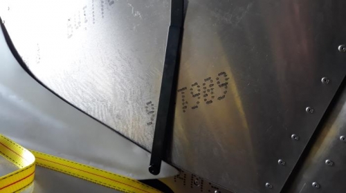

I had to re-drill two holes that were too close to the edge of a bulkhead. I measured on the left side and transferred these measurements to the right side, but the fairing isn't exactly symmetrical.
I used a strap duplicator that I just learned about the other day to locate the rivnuts and drill the holes in the fairing. What an awesome tool!
I'll need to patch the two old holes in the faring before paint.
