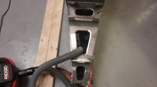

Brief Description:  Vacuumed out rivet removal debris

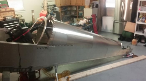

Today I vacuumed out all of the rivet heads and stems caught in the fuselage from drilling out rivets. The ones in the tail cone were relatively by lowering and shaking the tail of the aircraft to get them biased to one end. I had a few that were trapped between sheets of the cockpit floor, so I used a roofer's magnet to steer them to an opening that I could then vacuum out.
Gravity is your friend
sucking out rivet heads

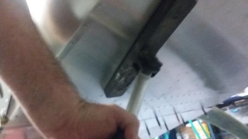

used a magnet for the pesky ones
