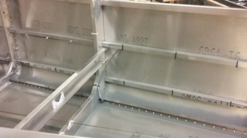

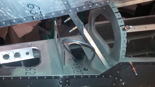

Brief Description:  Installed wiring for magnetometer
I installed a 3 twisted pair sheilded wire cable for the Garmin GMU 11 magnetometer in the tail cone. The wire enters the cockpit on the right side floor, and I will route it to the dash through the console after I fit in all of the controls.
wire routing in tail cone
