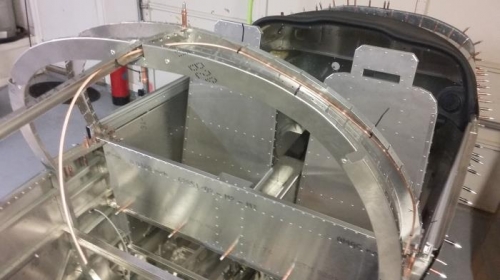

1 - Routed GPS antenna coax
Today I routed the GPS antenna coax above the luggage compartment. It will be 2 ft or more away from the COM, and still clear the sliding canopy. I used RG400 coax.
GPS coax routing

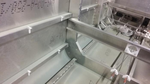

longeron wire routing
