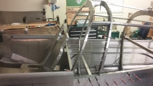

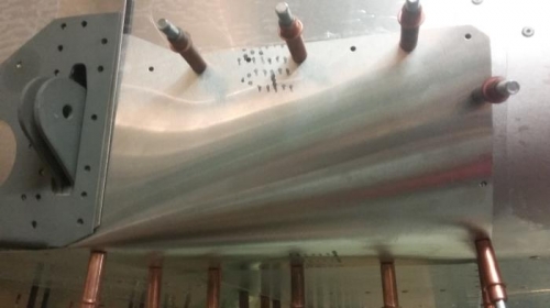

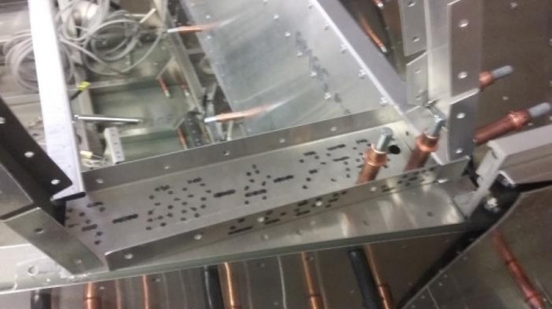

Brief Description:  4 - transition piece, joining bracket and rear can
I fit the transition piece(s) in several different ways of under/over/between skins (no drawing info) until I found one that I liked and made sense to me. I then fit the joining brackets temporarily to see the design intent which is for the rear canapy skin. So I then fit the rear canopy rib to check out the peices fit together. The rear canopy rib will require bend modifications for the inside skin as I have seen on other build websites.
