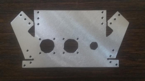

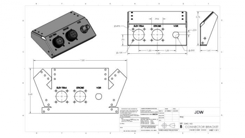

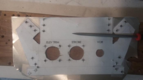

I designed a connector bracket in solidworks to mount the strobe, elevator trim and vor antenna conenctors under the vertical stabilizer. I used a drill, file and shears to fabricate it from .024" thick aluminum.
bracket design
holes drilled and filed
part cut out with snips
