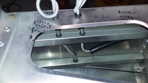

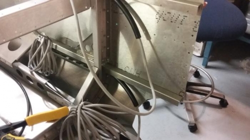

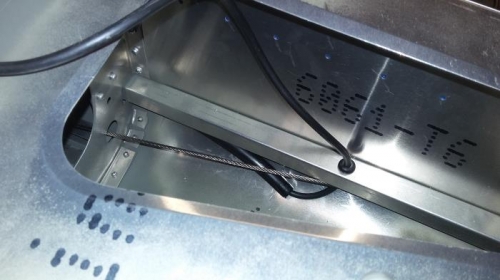

I found some tubing in my garage that was just the right size (5/16" ID) to serve as wire run conduit. I don't remember buying this so maybe it came with the kit? I don't know, but it worked great. I ran the strobe & trim wires and the VOR coax through the tubing and grommets. I'll need to secure the tubing with tie-wraps and drill holes for grommets at the luggage bay exit.
wire exit at rudder end
wire exit at luggage bay
VOR coax exit at rudder end
