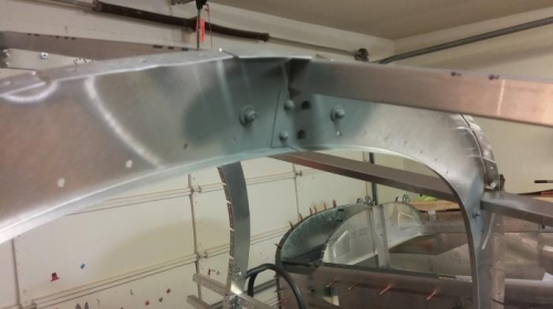

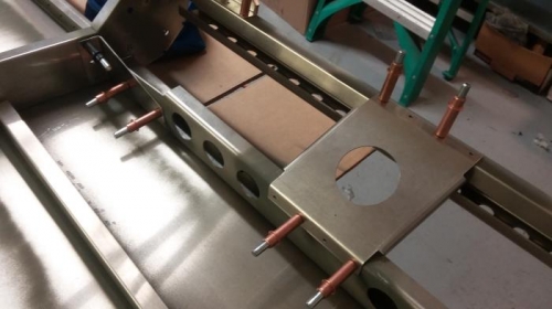

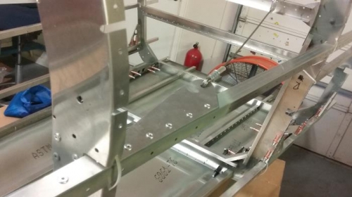

I used scotch bright and self etching primer to prepare the brackets for installation and then clecod them in place. I riveted the two shoulder harness cable brackets in place, and primed over areas on the ribs like seams and washer plugs.
Step brackets primed & clecod
Safety harness cable riveted
Primed over washer plugs
