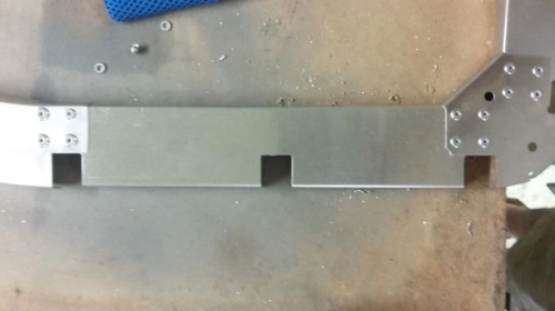

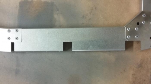

I noticed while inserting the longerons that Rib#2 was assembled with the Left and Right sides reversed. In the first photo you can see the correct gap in the middle with the left one too small and the right one two big. The next photo shows the rib reworked to the correct configuration with all three longeron gaps the same.

Assembled wrong side (L&R)
Drilled, reassembled & riveted
