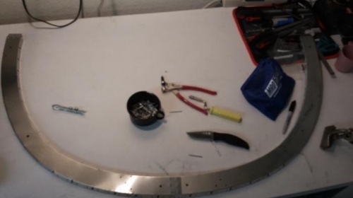

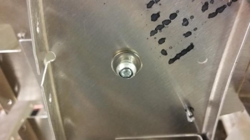

I finished riveting the RF ribs by completing Rib #2. I then went back and sealed the tooling holes per the drawing with 3/16" rivets. I used a SS washer on the backside to reduce the clearance. I spray primer over these plugs to prevent galvanic corrosion.
Rib #2 completed
Rib #2 completed
Sealed tooling holes
