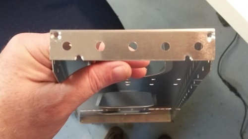

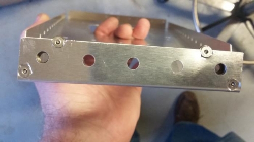

Brief Description:  Started rear fuselage
I started the rear fuselage today. Ran into problems immediately with parts and instructions. I believe the nut plates are supposed to be installed after the rib is joined.
Yep, just verifed on the new documentation i recieved online. Should have looked there first. I'll rework tomorrow.
hole are on edge and dont CS well
definetly not looking right
Oh, the new drawing is much clearer
