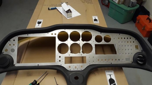

Brief Description:  Test Fitting Panel
I test fit the components to the panel and deburred where necessary. The water jet cutter has a bit of draft to it, so I had to remove this on some holes.
Some of the mounting holes don't have corresponding rivnuts on the dash, so I'll match drill these later.
I'll also need to clear out some flange areas of the dash where components interfere.
I have everything I need now to paint, label, assemble and fit the panel except for the circuit breakers.
Test Fit Panel to Dash
